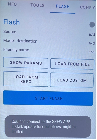

Then, I opened the ScooterHacking Utility (v.2.04), and I saw the message:
“Couldn’t connect to the SHFW API!
Install/update functionalities might be limited”

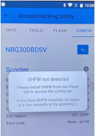

I went to the CONFIG tab, and I got the message:
“SHFW not detected. Please install SHFW from the flash tab to access the config tab.
If you have SHFW installed, try again in a few seconds, or try updating it.”

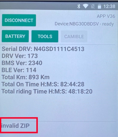

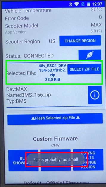

3. By seeing this issue in the SHU app, I tried all the other apps, ending up with the same problem, I’m not able to flash the 48v custom firmware now.

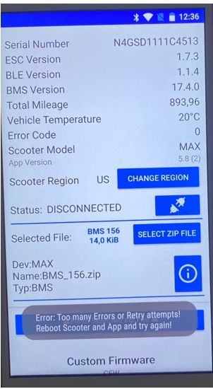

Getting these errors when I try to flash:
4. Next attempt, was to in somehow downgrade the ESC/BMS and BLE versions and upgrade them again, to see if something that was wrongly installed could it be fixed.
I was able to downgrade and upgrade to all the (ESC and BLE) versions available in the SHU app, and in the middle of those downgrade and upgrades, was detected restrictions that were fixed.
However, BMS cannot be changed, not sure if it could be this the problem, but I am in the version 2.3.4

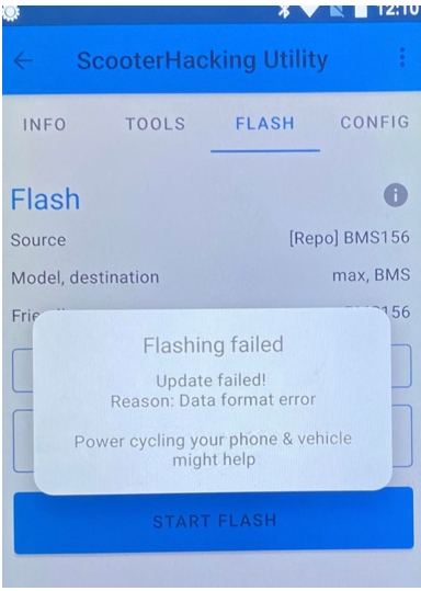

The error when I try to downgrade:
(Flash failed, Update failed! Reason: Data format error. Power cycling your phone & Vehicle might help)
By seeing this message, I fully charge the escooter battery and the battery of the phone as well, but no changes after that, error persist.
And cannot be downgraded as well with other apps as well:

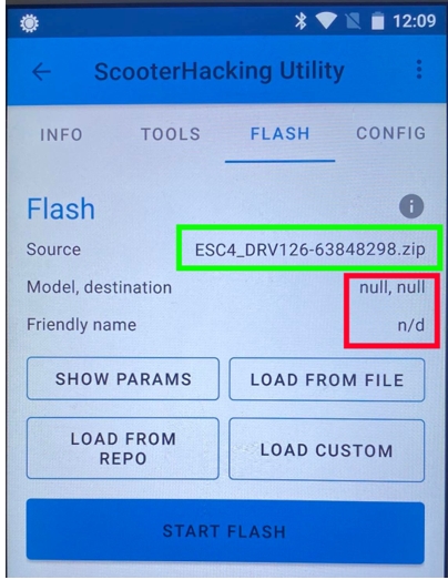

When I select a file to flash, I see that the fields:
“Model, destination” and “Friendly name” are showing strange values: “null, null” & “n/d”, not sure if it should be the values that I should see here, might probably be something related to this, no clue.
As it can be seen, I also tried the Base firmware version DRV126, instead of the 154(beta) that I was initially trying, but once again, nothing changed, errors persist.

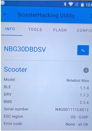

Here's my current setup BLE/DRV/BMS versions:
At this point I've exhausted all my ideas on how to try to solve the problem, and I'm already very frustrated, because I had the whole system running at 48v, and now I had to revert, and I'm stuck in this situation.
