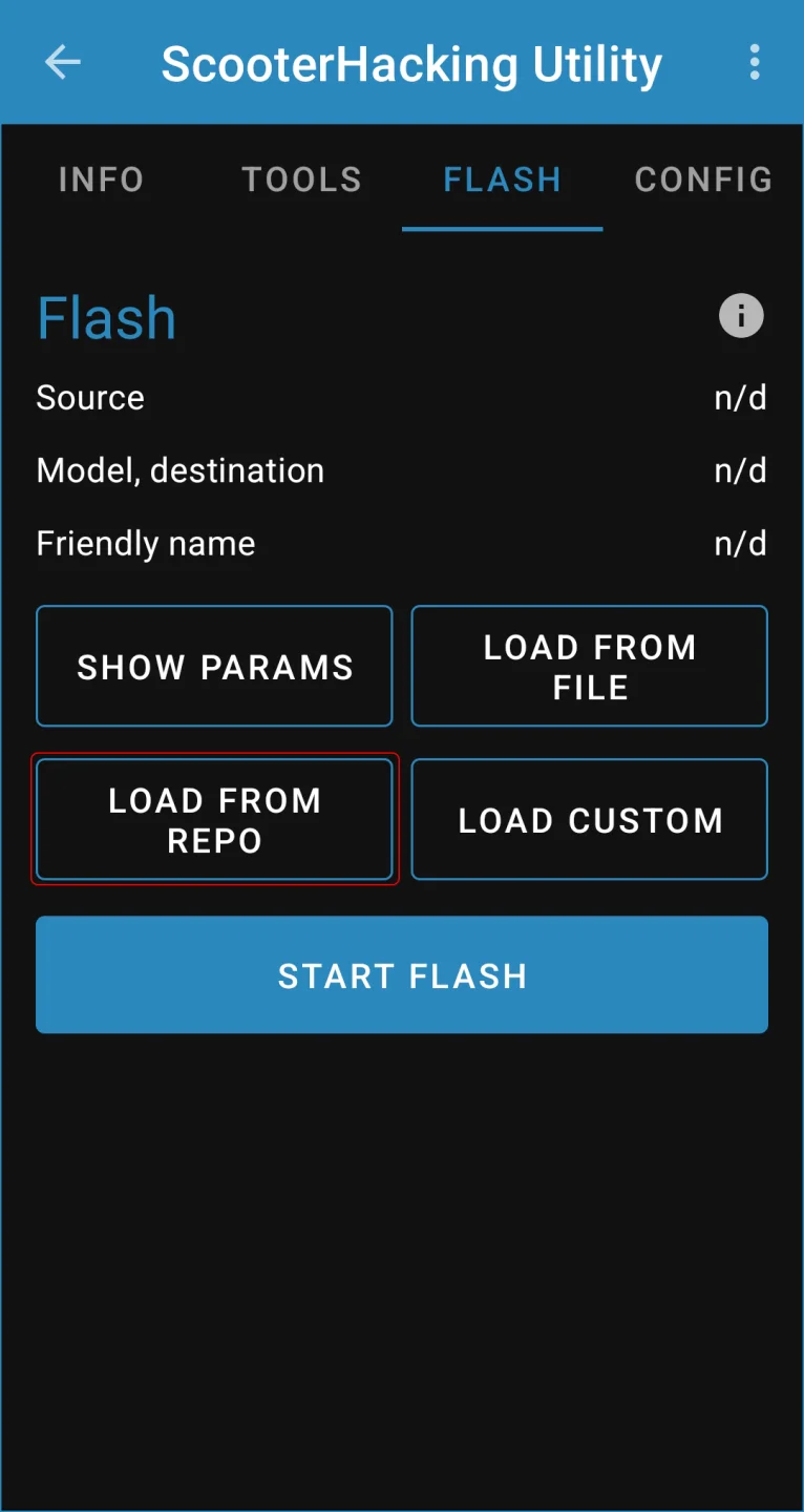

First of all, we start the Scooter Hacking Utility (hereinafter abbreviated SHU) on our Android device.
The next step is to connect the SHU to our scooter via Bluetooth.
Now we select the button "LOAD ORIGINAL" (soon LOAD FROM REPO),
navigate to the "patched" DRV2.7.1 and flash it by pressing the "FLASH" button.

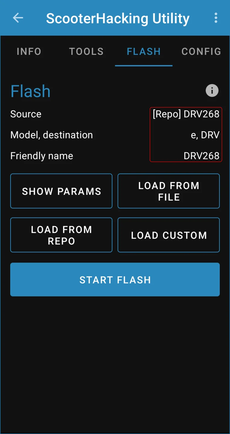

After successful flashing, we can now downgrade to any DRV version.
I would recommend downgrading to DRV2.6.8.
