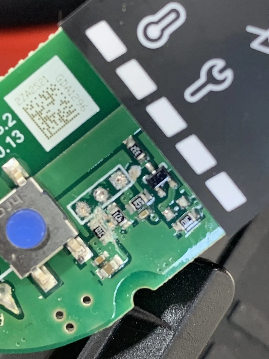

Hilfe! die Downgradeverbindung ist abgebrochen, jetzt ist mein Display tot.... nur noch kurzes aufflackern des Rücklichtes beim einschalten

Dann musst du dein dashboard mittels st link wieder flashen. Ist mir auch passiert, aber nur, wenn das dashboard angeschlossen ist.

Info : The selected transport took over low-level target control. The results might differ compared to plain JTAG/SWD
Info : clock speed 1000 kHz
Info : STLINK V2J37S7 (API v2) VID:pID 0483:3748
Info : Target voltage: 3.083535
Info : [nrf51.cpu] Cortex-M0 r0p0 processor detected
Info : [nrf51.cpu] target has 4 breakpoints, 2 watchpoints
Info : starting gdb server for nrf51.cpu on 3333
Info : Listening on port 3333 for gdb connections
target halted due to debug-request, current mode: Thread
xPSR: 0xc1000000 pc: 0x000006d0 msp: 0x000007c0
OCDEXPDUMP 13-06-2022_14-29-27
OCDINIT 13-06-2022_14-30-01
Open On-Chip Debugger 0.11.0+dev-00626-g92c4e634d (2022-03-19-11:44)
Licensed under GNU GPL v2
For bug reports, read
http://openocd.org/doc/doxygen/bugs.html
Info : auto-selecting first available session transport "hla_swd". To override use 'transport select <transport>'.
Info : Target voltage: 3.085060
OCDERASE 13-06-2022_14-30-01
Info : Target voltage: 3.082009
Error: jtag status contains invalid mode value - communication failure
Polling target nrf51.cpu failed, trying to reexamine
Examination failed, GDB will be halted. Polling again in 100ms
Info : nRF51822-QFAC(build code: A0) 256kB Flash, 32kB RAM
Error: Error waiting NVMC_READY: generic flash write/erase error (check protection etc...)
Error: Failed to erase reg: 0x4001e50c val: 0x00000001
Error: Failed to erase the chip
ERROR :OCDERASE 13-06-2022_14-30-02 no Connection, errors=1 speed=1000
OCDINIT 13-06-2022_14-30-07
Error: init mode failed (unable to connect to the target)
ERROR :OCDINIT 13-06-2022_14-30-08 no Connection, errors=2 speed=1000
OCDINIT 13-06-2022_14-30-13
Info : Target voltage: 3.080483
ERROR :OCDINIT 13-06-2022_14-30-13 no Connection, errors=3 speed=1000
OCDINIT 13-06-2022_14-30-18
ERROR :OCDINIT 13-06-2022_14-30-19 no Connection, errors=4 speed=1000
OCDINIT 13-06-2022_14-30-24
ERROR :OCDINIT 13-06-2022_14-30-25 no Connection, errors=5 speed=1000
OCDINIT 13-06-2022_14-30-30
Info : clock speed 400 kHz
ERROR :OCDINIT 13-06-2022_14-30-30 no Connection, errors=6 speed=400
OCDINIT 13-06-2022_14-30-35
xPSR: 0xc1000000 pc: 0xfffffffe msp: 0xfffffffc
OCDRESET 13-06-2022_14-30-37
OCDINIT 13-06-2022_14-30-37
OCDWRITE 13-06-2022_14-30-38
Info : Target voltage: 3.086586
** Programming Started **
Info : Flash write discontinued at 0x000007c0, next section at 0x00001000
Warn : Adding extra erase range, 0x000007c0 .. 0x000007ff
Error: Flash sector 0 is protected
Error: failed erasing sectors 0 to 1
embedded:startup.tcl:1162: Error: ** Programming Failed **
in procedure 'program'
in procedure 'program_error' called at file "embedded:startup.tcl", line 1227
at file "embedded:startup.tcl", line 1162
ERROR :OCDWRITE 13-06-2022_14-30-39 no Connection, errors=7 speed=400
OCDINIT 13-06-2022_14-30-44
ERROR :OCDINIT 13-06-2022_14-30-44 no Connection, errors=8 speed=400
OCDINIT 13-06-2022_14-30-50
OCDWRITE 13-06-2022_14-30-51
ERROR :OCDWRITE 13-06-2022_14-30-51 no Connection, errors=9 speed=400
OCDINIT 13-06-2022_14-30-57
ERROR :OCDINIT 13-06-2022_14-30-57 no Connection, errors=10 speed=400
OCDINIT 13-06-2022_14-31-02
ERROR :OCDINIT 13-06-2022_14-31-03 no Connection, errors=11 speed=400
OCDINIT 13-06-2022_14-31-08
