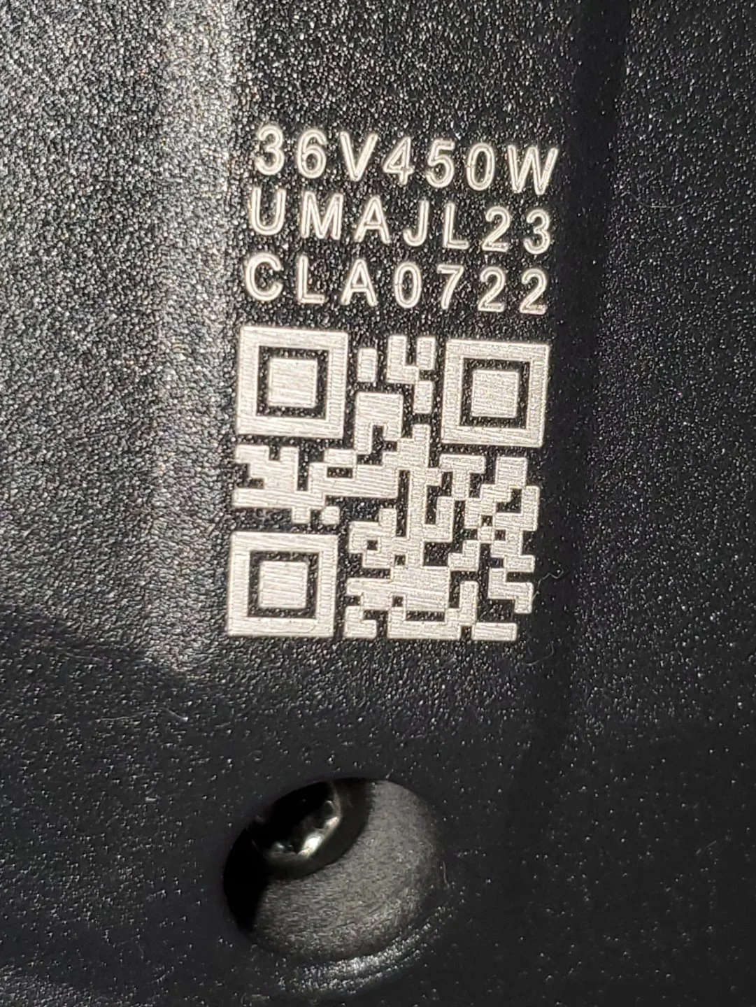

Please post a picture of the label on you F2 plus motor so i can add those informations to the first post.
My F2 Pro motor has this:
36V450W
UMAJL23
CLA0722
