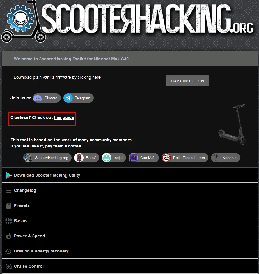

You always can read the English version of the Guide that I've made of the German one.
Shouldn't be that difficult to gain access too... ;)
